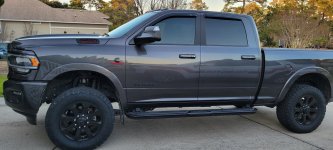

I put 35 12.50 / 20 Toyo Open Country AT3s on my stock rims. I got a little nervous and used that as an excuse to put a 2 1/2 leveling kit on, with 1 inch in the rear. That eliminated any chance of rubbing.
Rubbing on the sway bar and radius arms (where oversized tires rub with stock wheels) isn’t eliminated with a lift, it’s done with different backspacing on the wheels.
No backspacing. Stock wheels and no rub.
