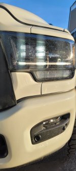

Also curious about the accent lighting on the Limited trim, picture attached. Is it possible to just have the horizontal signature led on without the 4 inner leds next to the projectors? or are they tied together?
