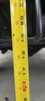

Ground to bottom inside of hitch 19"

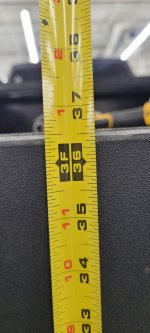

Ground to bed floor 36.5"
