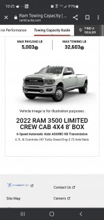

My '22 HO 3.73 limited has a trailer tow cap of 32,600, I found a very similar 4.10 truck and the trailer tow cap was only about 2000 lbs more
This is my 22 DRW HO Limited Longhorn with the 3.73 rear axle. I would assume, with a tradesman trim level, the numbers represented would be a little higher than mine due to the reduction in options and other “goodies”. (Door sticker matches this information)2D52F99A-435A-42FC-B0DF-3A20222CA596.jpeg
The difference would be minimal. There is only a 1,400 lb difference in the GCWR.

The way max tow is calculated you subtract curb weight, 300lbs for driver/passenger, 100lbs for accessories/gear, and 70 lbs for the hitch.
If the tow rating was 35,200 that means the curb weight was 7,330 which is what a CC DRW Hemi is.

I’ve got 2022 tow charts saved from when they were released. 43K is the max GCWR I’ve seen on CC trucks. 4x2 reg cabs did get a 45K GCWR, which equates to a 37K tow rating.
