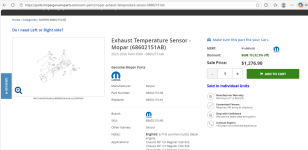

I have a 2025 Ram 5500, took delivery on Nov.12/25. P2482 code and de-rated on Nov.24/25. And out of service. No replacement part available until mid Jan. I can’t believe how unreliable this combination has become. It seems that Ram has no issue forcing loyal clients to absorb the losses created by a defective product. I get it! It’s the EPA regulations that create these issues, but Ram/GM/Ford have had 15+ years to figure this out. Having no parts to repair is purely a failure in leadership, no excuses!!

Bank 1 , Sensor 5. To the best of my knowledge it is the final sensor and module after the SCR. Part #68602151AC

ok.... by doing a quick search appears to be an "Exhaust Temp Sensor"---This part number ends in AB--rather than your AC, but is probably the same part.

I was just on the phone with the dealership, all 2025/26 models 3500 and up use this new sensor. Dealers can’t order this part without Corp. approval, seems like quality control measure. They could only scan and send report to Corp for approval. Part is then ordered for them. Dealership does not have new 3500 to take sensor from or even if that is permitted, I don’t know. We are still exploring that option though.

Haha! No weight loss program for me, too many scale crossings and fines and impoundment to costly. The current configuration requires more attention to maintaining the Egr system because that’s where the real damage can happen. I think this is the first year for these sensor having attached modules. The modules doing the calculation for the ECM. Without having an old part, the sensor is a thermo resistor with a small circuit board inside the module measuring potential difference. I suspect that a very small component like a resistor or a diode has popped on that board. But yes the price is extreme for a sensor
