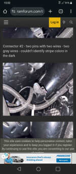

What is this connector used?
Do you mean the type or what it is for?
Where is it located? You can't just post a close up pic where we can't tell what part of the truck that is.
it is the plug for the receiver for the trailer TPMS. You can add the hardware and program it with AlfOBD of you want that functional.
That’s not the TTPMS receiver connector.
The connector in the pic is for the rear bumper passive entry antenna for passive tailgate release.
