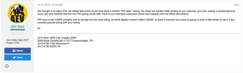

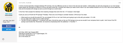

I have concerns about the weight of the truck. I know, I know - "how can I increase payload on my Power Wagon"... - my original note above about AEV recommending to swap out the softer Power Wagon springs to the stock HD springs helps to address this. While doing some more digging on the topic, I came across some posts on the AEV forum from AEV Dave (signed 'dh') who I surmise is Dave Harriton, who said as such, stating "the non-PW spring would add...more load capacity and not affect articulation".

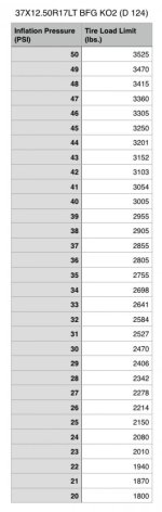

This was an interesting note because of the current weight of my vehicle. Per the Stellantis propoganda, a stock 2022 Power Wagon with Rambox has a curb weight of 7045#, with a GVWR of 8565#. The truck, as it sits currently, has the AEV lift, AEV front bumper, AEV rear bumper, 17" AEV Katlas with 37"12.5xr17 BFG KOs, White Knuckle sliders with top step, a set of Rigid D-Series Pro lights, stock 285x70x17 Goodyear Wrangler spare tire, and the Warn Zeon-12s with synthetic with about 40# of recovery gear (tire repair kit, ropes, shackles. snatch blocks, bottle jack, etc), and about 50# of additional gear (e-tool, air compressor with cable, ratchet straps, etc). I took the truck up to a CAT scale and she weighed in at 8340# (4620# front / 3720# rear) with a full tank of gas. The GAWRs for a stock 2022 Power Wagon is 4750# front / 6200# rear. My current payload, when using the GVWR on the door placard, is 225#. Shameful, but I must say, the truck does not drive as if it is approaching the GVWR, most likely due to the changes of the AEV lift impacting steering geometries, but also, most likely due to the changing of the springs. In the AEV post from 'dh', he also notes that the reduced GVWR for the Power Wagon is also due to the stock tires, which were also changed out, so I still feel comfortable running adding a roof top tent over the bed, knowing that I have the payload to do so, but will legally be exceeding the GVWR.
And with the benefit of knowing the actual weight of the vehicle with all the extras, I am able to dial-in the tire pressures for the BFG KOs, which are a D-load tire rated at 124 R (106mph), which at a max of 50psi support 3525# per tire. So, based on math, I should run 28psi front (2340# per tire) with a rear pressure of 22psi (1940# per tire) based on the load inflation tables from BFG. With proper rotations, this would yield the proper wear pattern, but my OCD cannot handle the light on the dash from the TPMS. Even with the AEV ProCal Snap, which allows me to lower the TPMS threshold as low as 35 psi, it still illuminates a lower pressure warning. The TPMS should not trigger until the tire pressure is 75% of the threshold, so I should have as low as 27psi before the TPMS warning triggers.

I plan to run the tires as 33psi front / 28psi rear to avoid the TPMS headaches. Anyone else running their D-rated 37's this low psi? When airing down, what pressures are your running for trails if you are already aired down this low for daily driving? I would appreciate the sanity check.
Not saying you're wrong but those are similar pressures I would daily my Jeep Wrangler on, not sure Id run that on my Power Wagon. Currently my fronts are 45, rear 40 and I get damn near full contact patch, good riding quality so I am content with that. Id also suggest looking into the reviews on the articulation from the HD springs on the PW, its well-documented they leave a bit to desire. If I were in your shoes, Id probaby go to Carli or Thuren for a spring package that will net you the articulation and load rating you're looking for. Ive even seen but on FB getting custom rear springs made for their 2500 and was able to legally get their trucks rating increased.

It strikes me as odd that AEV replaces the OEM PW springs with springs from the 2500, as their whole shtick is that there are dozens of combinations of springs depending on the model of truck and options, and on and on. Dave even talks about it on one of his videos depending the brackets and spacers for the springs of the kit.
It's pretty nice to see Dave talk about tire rating and spring as being the things that affect the load rating. So many guys seem to think that since nothing can legally change your GVWR/GAWR it's set in stone and that physical items (higher weight rated tires/wheels, airbags, etc.) don't actually affect what your truck can carry in the real world. It's refreshing, if also a little shocking, to see.
