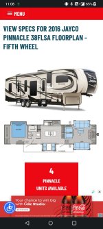

New to towing 5th wheels, found a deal on the attached unit but concerned it's over my capacity.
It will just be me and my wife,and dog living in it full time. Any input is appreciated.
If it is over your trucks towing capacity do not by it - that is not a good deal. Or, buy another truck that is equipped to to tow it as well.
