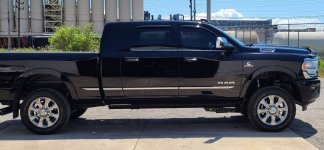

Well, I had some time yesterday and while everything was in except for the track bar I went ahead and installed everything. When I set it down on the ground, WOW is what came to mind right away. Pictures don't do the lift justice. I took it out for a ride and was real happy with it. The rear didn't change much if at all but the front seems to glide over small bumps in the road now. I'm glad I dove into this and did it. all in all it took me about 10 hours but a lot of that was reading and re-reading. Off to go fuel her up and give it a good run !20200625_134146.jpg
