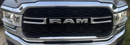

I am researching and working out the details on adding the surround view cameras to my Tradesman. Overall, I think I have an decent idea of what I need to do this. But when looking at the grilles on the various parts' sites it's hard to see exactly what's what. Are the grilles not sold as one part? It looks like there are several pieces to each type of grille with separate part numbers (and separate costs). Are there any parts of my current grille that would fit on another grille that will accept the front camera? And/or, if I have to buy multiple new grille 'parts', is there a simple way to know what parts go with what other parts to make a full grille?
I think all of the current grilles are equally appealing - the reason for a change is purely matter of function. Here's my current grille for reference:
Your chrome grille surround is 7 total pieces including the upper trim backing that will fit any other grille. The chrome "nostrils" or C pieces on either side as well as the RAM badge will also. The clips that hold these pieces in are fragile and the grill needs to be removed to remove those 3 pieces. Plus the grille itself is a separate piece of course. Those parts are all interchangeable. As far as what is needed for the cams, I'm not sure. I have pics when I did mine, just can't find them.
