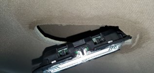

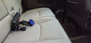

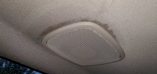

It has been raining for many days where I live. Today, I noticed water in the back seat. It appears to be leaking from two places: around the dome light and around the left rear speaker. Pictures below.
I verified the following:
  • The sunroof is fully closed without any debris in the seal.
  • The sunroof is not in "vent" mode.
  • All windows and doors are fully closed.
  • I looked and felt around in the cavity behind the dome light, but I can't find the source of the leak.
The truck is parked on a slight uphill grade, so I wonder if the sunroof drains are in the front of the cab above the water line. I am taking it to the dealer, but has anyone else experienced a leak like this?
@NAllyn96 reported his cab lights leaking in the front, but my leak seems to be coming from the rear of the cab.

The service department identified the source of the leak. It is coming from the seal around the third brake light on the top of the cab. They should have it fixed with a new seal tomorrow. I will report back if the new seal doesn't resolve the issue.

was there any water damage to the headliner or the speakers?
They should be replacing that headliner. Mine leaked a little on my 2015 and left water stains. My bumper to bumper warranty was out though. So I fixed it myself
