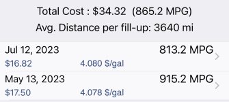

Mine does same. I have a 35” fifth wheel that’s roughly 15000lbs. When I took it to Florida and back I nearly used any def. Reason being (I’m told) is that truck under load is burning all the fuel and getting hot enough to keep itself clean. Def is for cold engine and when fuel is not fully burned so it gets in there and heats up and fires up and other fary **** to pass emotions. That said, as long as you are consuming def after working the truck you are good to go.
You haven't been given very good information. Bottom line is the harder you work the truck the more DEF you use, this is because there is lower EGR flow at higher engine loads so all of the NOx has to be controlled with DEF. When towing I burn double the DEF I do empty, that applied to my 2018 as well as my 2022. Aside from too cold of an engine/exhaust and coasting you are using DEF all the time.
What you're talking about is more aligned with the DPF and fuel consumption, but that still doesn't deal with the motor being cold. The DPF doesn't catch partially burned fuel, it captures particulate matter which is always present with diesel combustion. When the engine is working hard the DPF is hot enough to clean itself passvly. This can reduce the frequency of active regens, but those will still occur every 24 hours of engine operation regardless of DPF soot load levels.
