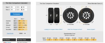

Waited and waited, explored looking for some other 18" Fuel wheels but no better luck. Earlier in the month I saw some Fuel Vapor wheels on a Super Duty in 20" size so I looked it up and it was only 1" less in sidewall on a 35" tire on a 20" wheel vs an 18" wheel. (7.5" vs 8.5") Called my local store and they were able to find a set of 4 Fuel Vapor D560's and although the tires would cost about $80 more per tire, I said let's go with those.
The OE DuraTracs rode very nice and balanced, even at highway speeds. So far the same thing with the new DuraTrac RT's. Plenty of room with the HD Rebel suspension. Now, I just need to pull out my AlfaOBD and read up on reprograming the BCM for the new tire sizes. Tirerack says the overall diameter of my tires are 34.8" but when I measure with them on the truck (with a level), I'm only getting about 34.0". I might start with the circumference for 34.0" (2712mm) first and go from there. (34.8" circumference would be 2776mm).
