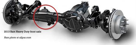

this type of thing wasn't available back when i had my 3rd gen, so i had to remove the front ds to
get my 2lo. it was so handy.
What is "the front ds?" Sorry, this is my first time owning a big 4x4.
[ETA] Sorry misread the post and didn't realize elephantrider meant driveshaft. I thought he was abbreviating disconnect.
Axle disconnect.
It's come and gone and come again in different years.
2020-02-28 13_26_16-2020-02-28 13_24_50-2019 ram fron axle disconnect at DuckDuckGo.jpg - Gree...jpg
