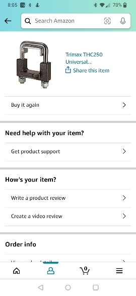

Has anyone found a 2.5 hitch clamp that works with the ram rear bumper? I’ve tried 2 different ones and it’s too close to the bumper and scratches the paint off the bumper or doesn’t fit at all since the bumper is so close to the top of the receiver. I bought a 2.5 shank for my WDH hitch but there is too much slop in the hitch for me.
I'm using this one with my 2.5" drop hitch.
Off Amazon.

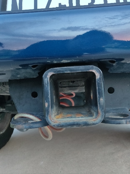

I tried that one and it worked amazing, but one 400 mile trip and it scratched a lot of paint off my bumper.

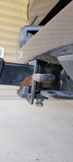

I have a 2021 3500. 6 inch drop hitch. You do want to make sure the shaft of the receiver is long enough. I'll try to take a picture when I go home for lunch.
@midntrdr, Tolerance is tight, but does not rub. Sorry for the rust on the shaft of the hitch. That was because of rub from my Chevy and I wasn't using the hitch clamp. Also in a coastal environment. Wish I'd run across this clamp years ago.
