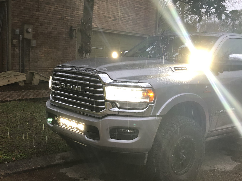

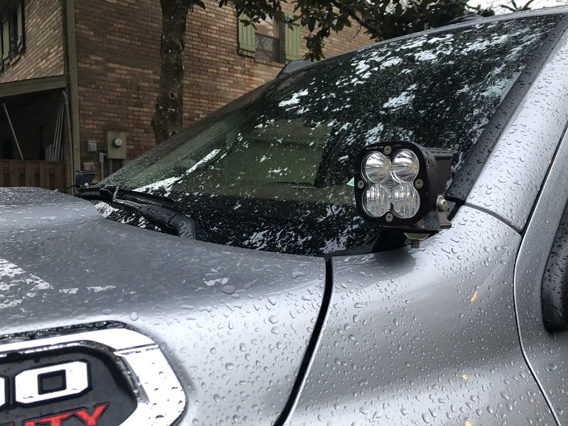

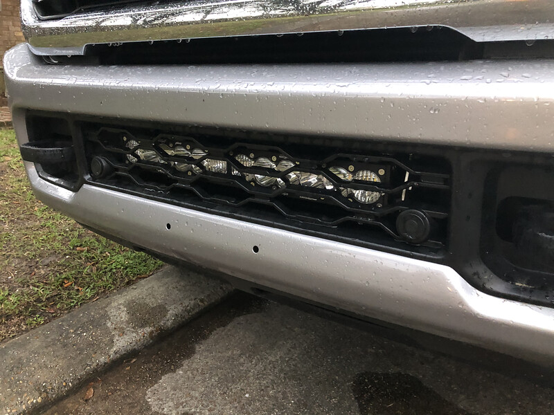

Here's the pics. I took them this morning. The last two are with only the BD lights on (I manually turned off the headlights) and as you can tell, it's daytime, but just cloudy enough to trigger the factory headlight sensors and they still throw off crazy light. The color of the BD lights is better than the competitors too. Unless you are looking for ricer boy white or blue instead of the best visibility...
Right on great picks. Do the a pillar mounts attach to the single fender bolt and if so how secure do they feel?
Yes. One bolt but the way they are bent braces them against the body on the inside to make them super secure. BD supplies rubber tape to prevent scratches and wear.
BTW, the bumper mount for the 20" bar is a PITA to install but there isn't really an easier way unless you remove the entire bumper. There are install PDFs on the product pages on their site.
Also, the instructions for the A pillar mounts did not include this but i trimmed the rubber trim piece with a razor knife to clearance for the mounts. Makes for a much cleaner install.
