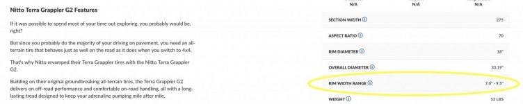

But wait there's more! If you have the Nitto Terra Grappler G2 in size 275/70/18 you are good to go.
