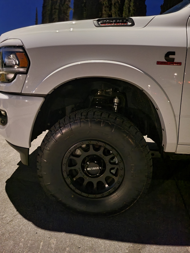

Here's 17'' with 35's. No difference I've noticed

35x12.5R17 Kenda Klever RT on 17" 2011 power wagon wheels. Stock ride height 2019 Cummins.
