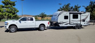

I have a diesel. How does your truck sit while towing? Level? WDH?
Thinking about Thuren +1 front springs. Keeping oem rear springs. I won’t pay their price for Fox shocks though. I have good aftermarket shocks already.
While 255/85R17 isn’t in my load and inflation table 255/80R17 is and it will be very similar… 45 psi is too little for the front with a diesel, and too much for the rear empty.
You should be running 50-55 up front with that bumper and 35 out back empty. I’d hit the scales before a long road trip….
Remove the front anti-sway bar, that’s a huge improved in jarring motion from potholes, curbs, gutters, etc. I notice a slight amount of increased body roll, and I mean slight, only because I know the sway bar isn’t installed. I still tow my 5th wheel on winding mountain roads and it’s perfect.
Thuren front springs would improve your ride over the spacers, along with the proper shocks for the springs. No need to go fancy thou.
For the rear, dunno… zero complains about the harness of the ride on my 2500. Sometimes it’s too soft, but overall it does pretty great for a coil spring HD truck. I still prefer the 3500 auto-level rear loaded on the road, but for hunting use the 2500 is much better than I imagined.
Yes I have a wdh and perfectly level. I too have 1” springs they actually lifted 1.5” and stayed that way. I too kept the stock rear springs and just air down when not towing. If you retain stock length shocks you could have issue with the taller springs. Don’t have to have Fox but the need to be the correct length. Definitely get the sway bar, makes a huge difference.
