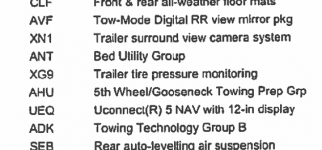

I have been working with a dealer to get a 2022 3500 ordered and it looks like the XN1 option is about $1000. Not sure if you will have to purchase a separate camera kit (like you do on the trailer camera kit).
That $1K is the 4 camera kit.
So you are saying I have everything ordered I need for putting a camera on the back of a 5th wheel and see it in the mirror?
The surround view camera displays on the Uconnect screen like the truck 360 does now.
To see a trailer camera in the digital rearview mirror, you need the XH7 camera.
