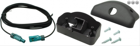

Second, the rear view camera has no mount or bracket for install. The body builders guide seems to state that you have to handle this yourself? How the heck do you mount this thing? I've included a pic of just the camera.

Per the camera doc, they do not provide any sort of bracket or housing. They do provide dims for one to be made.
This relocation kit is available, if a bit spendy @ $187 and just abs (probably) plastic. https://www.bobsmirrors.com/Factory...ith-360-Degree-View-Camera-Option_p_1521.html
I found this universal upfitter kit but not a retail source: https://www.zorg-na.com/product/4210/
If I was going to use one, this would probably be it. I could possibly build on in CAD to 3D print but my CAD skills are lame and it would take me forever to produce.
ETA: found this Zorg kit on Bob's cameras. https://www.bobsmirrors.com/Zorg-Mu...rd-Jeep-RAM-Trucks--Universal-Kit_p_1549.html
The bare housing only no cable no camera is $105.
@Brutal_HO, yah I've looked at the body builders guide on the Ram website a lot, but it doesn't appear to be up to date for a number of things. For example, I can't find anything yet on the tow mode camera. Also can't find anything on the 12 pin set up. Plus the part numbers in the write ups for the TPIS and surround view camera system don't match with what I have. Maybe there is more info available for actual upfitters?
I actually looked at both of those last night and ordered the first housing shown. It looks like it may be the best option I have for the back up camera.

I had the same questions when I received my truck. The first thing I found helpful was YouTube... After that I went to https://www.ramtrucks.com/ram-commercial/body-builders-guide.html and download the instructions for all the bags. Mounting the camera was done with silicon (not my choice) it seems to hold. 84E235E0-4687-4F8F-B91B-27E769F9A2E3_1_105_c.jpeg
The 1 question I still have, where is the wire to connect the "Trailer Surround View" @ the 7-Way to the rest of the truck?
My Cab and Chassis didn't come with a backup camera, but the factory harness was complete all the way up to the head end unit. OEM camera's weren't available at the time, so I ordered this unit: https://camerasource.com/catalog/pr...019-ram-surface-mount-cab-and-chassis-camera/ Just drilled a hole in the bed where I wanted it and and was good. It's not perfect, as the position is lower than intended which results in the field of view and guide lines not being where they need to be, but it does the job.
As for the other items, I only saw them briefly in the truck when it first was delivered. The up-fit was part of the original purchase and was complete before I took possession. The only items I have loose are the wiring harness for the auxiliary switches and the cold weather cover.
