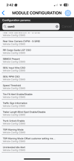

Maybe. Go to modules > body controller> configuration > search “csm3” and see if that setting is in the list.
Just a general side note about JScan- anytime you want to search an equivalent alfaobd setting in JScan, don’t use adaptations, use the configuration search in the body controller. The names of the settings are generally the same.
Did it tonight with JScan. Did exactly what @Jimmy07 suggested. It’s like the very last option “Unintended Engine something or other” but I disabled it and it worked like a champ.
I have everything attached again and working. Which csm3 setting controls it? The last three all show not set. Is it unintended idle alert?

I did change the “unintended Idle Alert”- which was the setting he mentioned in the video- from Not Set to set. I tested and got three honks. I then changed it back to not set. It still honks. Using Jscan vs AlfaOBD, there is not an alert on/off option. Only set or not set. Any other thoughts on getting Jscan to make this change?
It didn't work with JScan for me either on my 2023.
Sorry off the grid for a bit. That is what I did on my 24. Set the unintended idle alert to not set and it worked for me.
