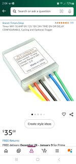

The timer i got from amazon, its fully programmable over wifi using your phone. I can look up the settings and will post it later

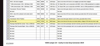

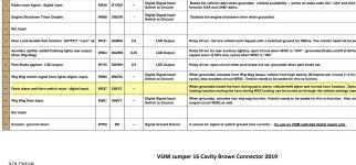

Here is the VSIM info, I have highlighted the wires that need to be used, the horn mute is in the brown connector and the door ajar signal is in the grey connector.

That's a fantastic idea - I use one of those timers on my air dryer purge valve, they are great. If you dig up which function you used in the timer that's probably 90% of it.
