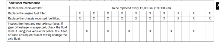

Do you actually need to change your different fluid if you don't tow frequently? I'm so confused by the manual. Is says for frequent towing change it every 1.5 years/22.5k miles. However there is no additional recommendation which implies if you don't tow frequently then you never need to change it? Something seems wrong.
Also how frequent is frequent? I tow about 25% of my miles, most of that with a 16k 5th wheel, but also some other lighter trailers too. Is that frequent?

I only put about 7000 miles a year on my truck but since 70% is towing a heavy fifth wheel, I change my diff fluid every other year or about 14K. I was using Redline but recently switched to Amsoil Severe Gear 75W140. They don't define what frequent towing means which just leads to more confusion. Sounds like just going by mileage is probably best for you. If my truck I would change every 20K.
Personally if your going to upgrade to a quality synthetic product like amsoil etc, your likely safe every 30k, maybe longer. 22k miles is a little quick in my opinion for axle fluid

I would change it IAW with the "frequent towing" timeline. While the OE fluid in the gen 4.5's is better than the gen 4's, it's still not great.
I use Amsoil Severe Gear diff fluid in all my vehicles. The Amsoil service interval is 50K severe and 100K miles normal use, Amsoil has definitions for both on their website.
I dumped my OE fluid at my first 12 month service with 13.7K miles on it. I haven't decided yet if I am going to follow the interval in the manual unit warranty runs out, or follow the Amsoil interval like I do on my other rigs.
I have 18K miles on my 2021 with approximately 60% towing. I just replaced my rear diff fluid with Amsoil Severe Gear to meet the 20K "frequent" towing statement in the manual. I will replace the front when I have time, and then probably stretch the interval closer to the Amsoil severe service interval (50k).

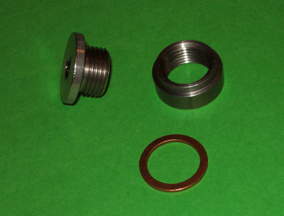

There is a guy on eBay who sells weld on diff. Plugs. I welded some in my 3rd gen, loved it
Used a greenly punch and mig welder
