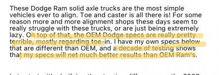

I need to get the truck in to my shop and have the alignment checked/set to the Thuren specs. I have a vibration between 65 and 70 MPH.
Hey Crusty, can you please expand more on this “Thuren specs”? I dont recall seeing you post anything about suspension upgrades or is it because you went up in tire size? Its been a while since i had a solid front axle (had a JKU quite a few years ago) but i dont recall having to get alignments done with my shock changes (no lift) and larger tires. My IFS rigs on the other hand if i even look at one of the components the wrong way…straight to the alignment shop..haha
Thanks for that! So it looks like he recommends getting an alignment regardless of mods.
Yea, only change is the bigger tires which dont require a alingment.
Reading several different post, I've decided to go with their alignment specs. That's all.

So I now have 3200 miles on the new tires. And I'm seeing some excessive wear on the outer edge of the tires with cupping/feathering.
That indicates a toe setting is out of spec
Going this moring and have my guy rotate tires and do an alignment using the Thuren specs. I'll see where they factory set it before we start adjusting anything.
