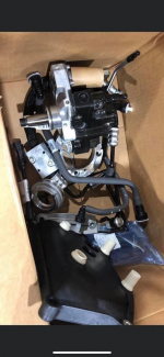

Revised TSB for CP4 failure replacement kit with CP3.3 pump retrofit: https://drive.google.com/file/d/1MQAFhqEr5mnCJ1VzIjOQBHzcqSEV260H/view
[MOD: CP3.3 retrofit kit]
index.php
New pump tag: CR/CP-ISB19S3/R110/30-789S
( 21+ tag is CR/CP-ISB21S3/R110/30-789S

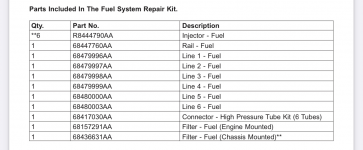

Base Y78 Recall pump kit:
Full failure mode additional parts:

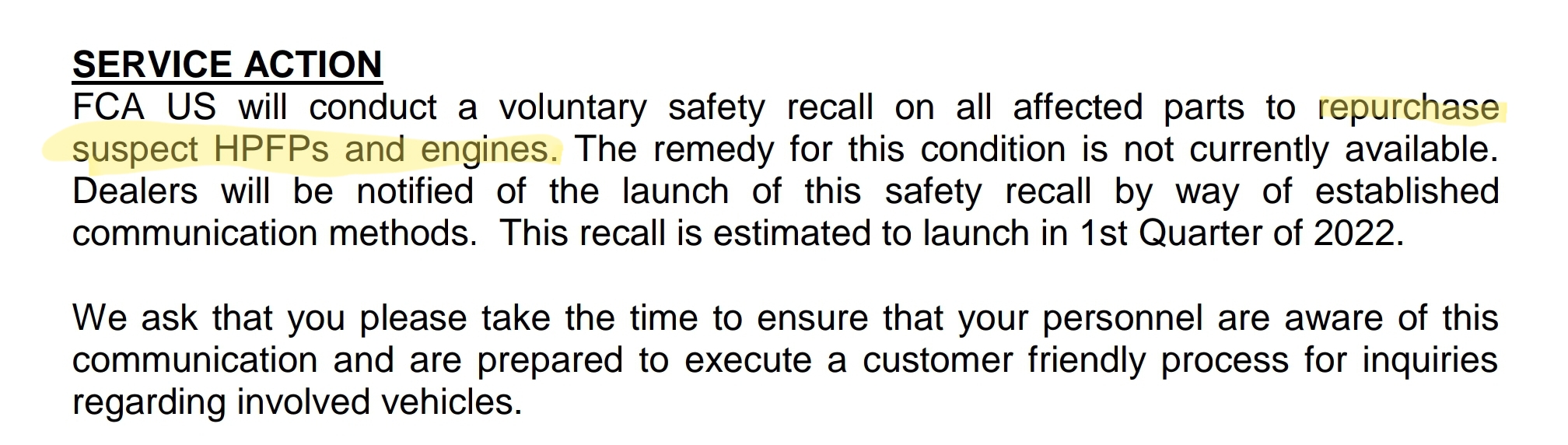

Just read an article that 2019-2020 trucks will be issued recalls for the fuel pump. The fix is to replace it. No idea which pump though. Ram/Stellantis acknowledged the recall today. Notification for the recall will roll out starting Jan. 1st

That note about "repurchase engine" might imply that FCA has considered full engine replacements being easier for dealerships to swap vs doing front covers and such, then do retrofit/reman at another facility.
ETA: I've seen mention of HPFP filter screen and engines being inspected for POSSIBLE replacement due to suspect damage.
Until these start happening, it's still a lot of speculation what will actually be replaced in the recall.
