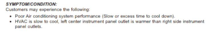

I took it to the dealer this spring and asked about the TSB. The dealer had never heard about it, so he looked it up. He said he needed to take the truck to diagnose, I showed him in the TSB that there is no diagnosis, it’s simply if vehicle built between dates A and B, and customer states X, perform TSB. @RamCares is there anything I can say to get them to order the parts for the TSB without them taking my truck for “diagnosis”.? Also should I expect to receive a free loaner?

The TSB itself can be found here https://hdrams.com/forum/index.php?threads/ac-fix-tsb-pre-8-20-build-trucks.3162/
There is no diagnostic for the dealer to perform, merely that the consumer experiences the following symptoms/conditions

I simply called the dealer and told them I would like the truck Serviced for TSB #24-001-20 because my truck has the symptoms described in the TSB, I asked they order the parts in advance (which they did).

If hot air comes out of the drivers side vents, then you have the problem.
