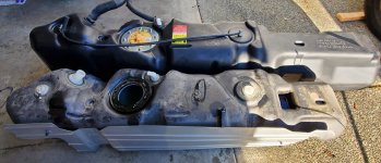

I bought the tank back in Sept. Hadn't gotten around to getting it in until today. I'll just say this now, I should have just paid to have it done. I am getting to old for this stuff. lol
Having a lift would have made the task much easier. Doing it on the ground kind of sucked. Anyways, took me about 4 hrs total I think. Still want to update the tank size with AlfaOBD so I get correct DTE.
I took a little less than 3 gallons from the stock tank to put into the new one. First fill up took 51.092 gallons. I didn't play the wait for it to vent game I usually do when filling up to get it all the way topped off.

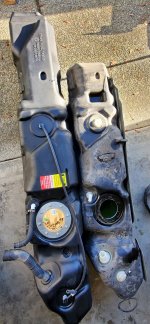

As you can see, the stock 32 gallon tank is quite a bit smaller than the 55 gallon.
