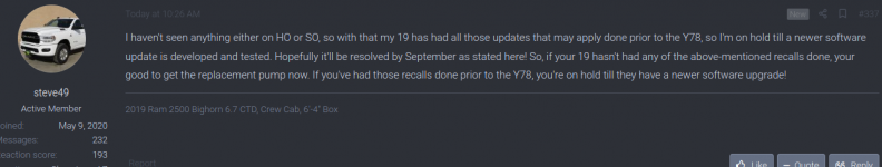

I haven't seen anything either on HO or SO, so with that my 19 has had all those updates that may apply done prior to the Y78, so I'm on hold till a newer software update is developed and tested. Hopefully it'll be resolved by September as stated here! So, if your 19 hasn't had any of the above-mentioned recalls done, your good to get the replacement pump now. If you've had those recalls done prior to the Y78, you're on hold till they have a newer software upgrade!

Looks like you just need one of them not done as i read it not all of them. But funny enough when i check on the mopar site i see recalls say done that i know were not done
Which further backs my statement (it's a case by case case) situation. My truck has those updates done in Jan and April, and as i indicated was\is missing and bucking since Jan. 2022. They replaced my HPFP, tank,injectors ,lines & filters two weeks ago now, and truck is back at dealer for further evaluation and hopefully repair.
